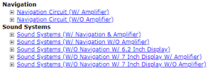

Depending on the schematic and version, one version is connected via a CAN network controller.
An error with a network controller / harness or microphone can be a possible error(s).
