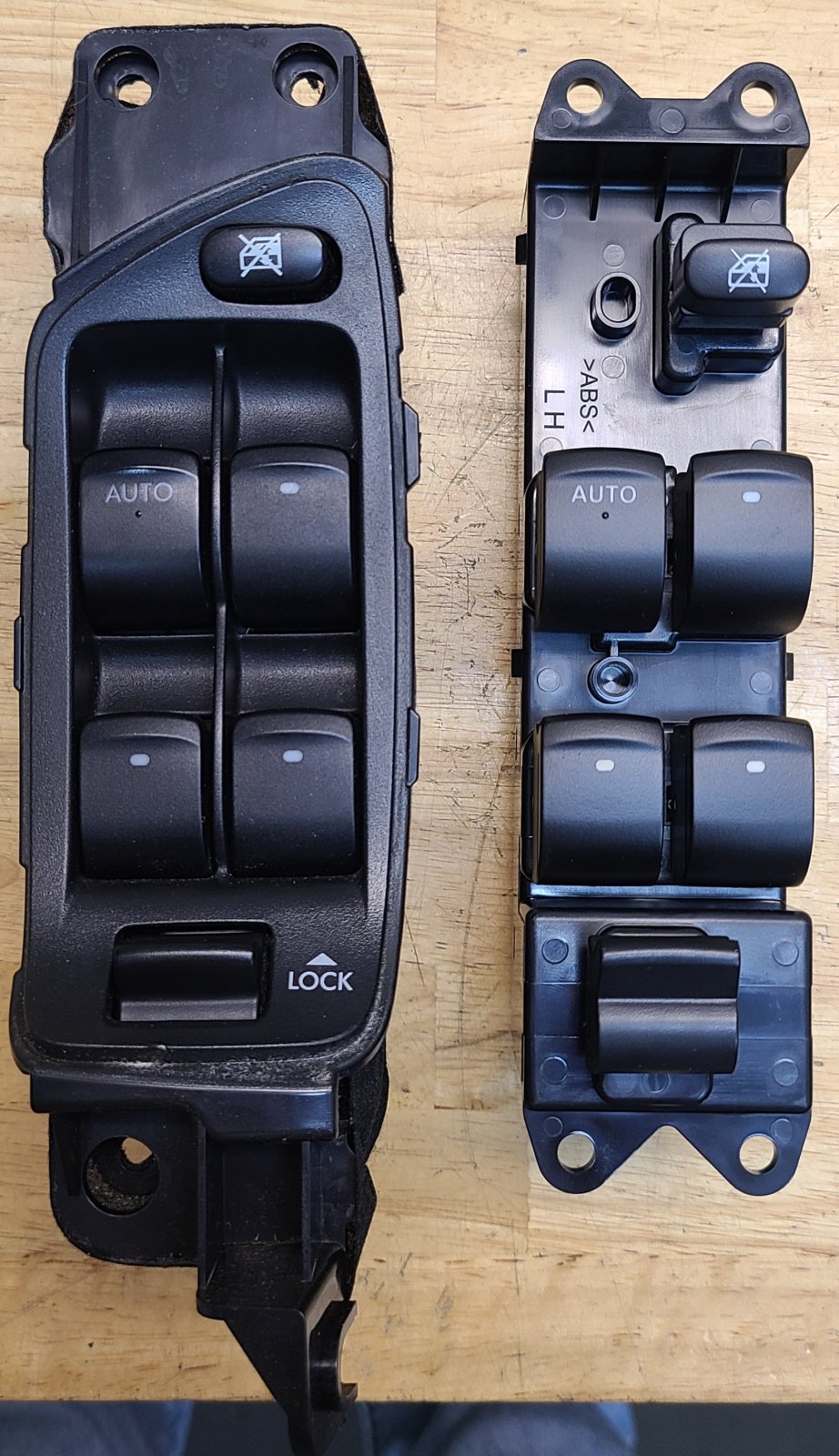

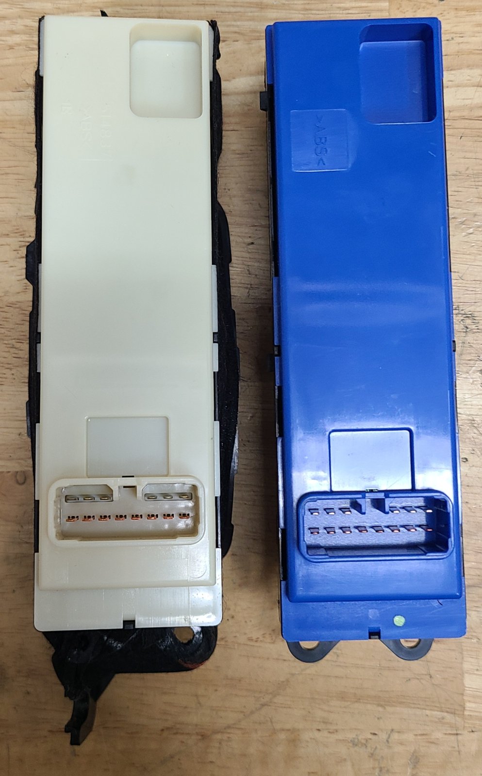

Anybody had experience replacing the drivers side window switches assembly? I'm concerned about the difficulty of popping the the door liner to get at the switch assembly.
Switch Doctor brand available on Amazon and elsewhere is decent quality.
