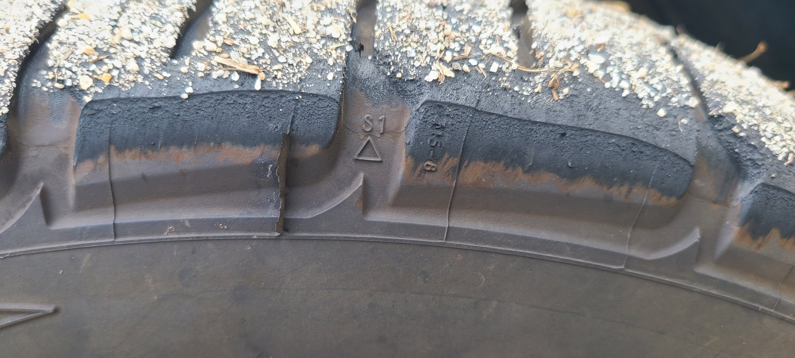

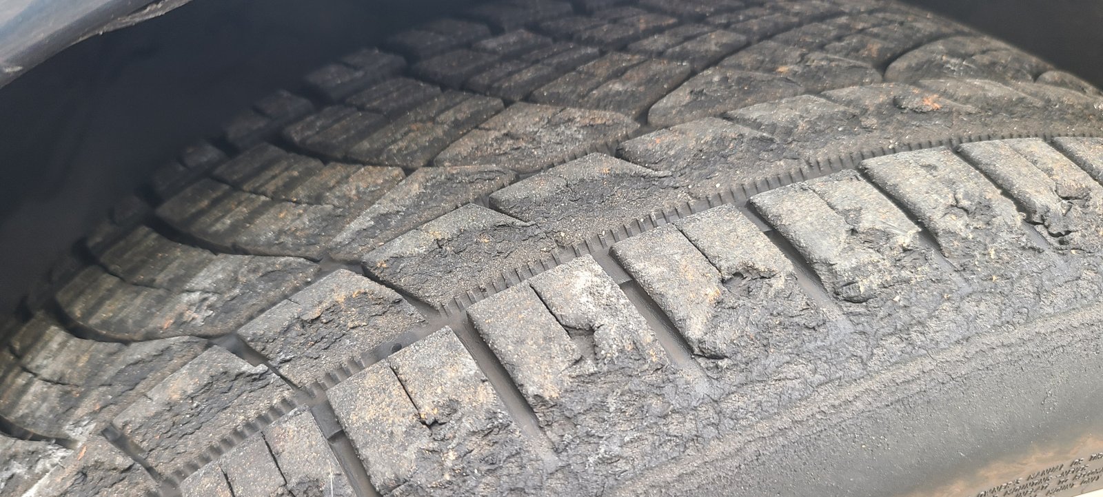

I got talked into Contis on one of my current rides. Never again. Love my BF Goodrich Comp-2 sets. Some places will take them back within a small mileage period.
What didn’t you like about the Contis?
Reduced grip and they couldn't handle aggressive driving at all, despite being marketed for it. They melted and came apart at the edges. Super soft sidewalls so they need a LOT of air. Comparison under the same conditions, Conti vs BFG. No comparison at all.
