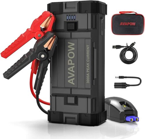

For the time being, use the battery maintainer until it's solved.
As an example, keeping one of these tools in the vehicle will save the day.
Caution: charge after use and never allow the device to freeze.
