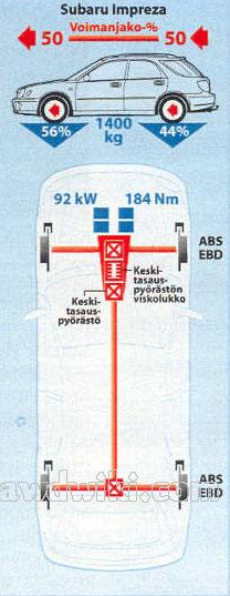

The transmission active torque split:
If the transmission active torque split is equal front to back and the torque converter is operating correctly, then you will know there is damage to the hydaraulic transfer clutch.
That is why I eliminate all other possibilities and diagnose the offending component.
