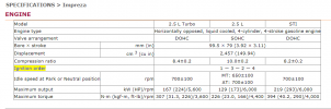

Maybe you should use these images with the engine partially assembled.
As the engine rotates from 0 Deg, follow the graph to see the correct valve openings at the the specific illustrated Deg in the graph.
