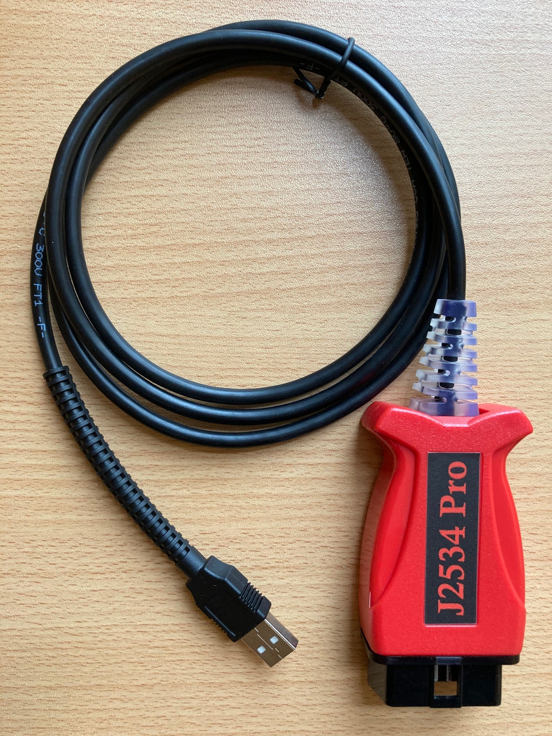

This may also work, I have something similar:
And have it on a separate drive in a Dell D630 or Dell E4600.

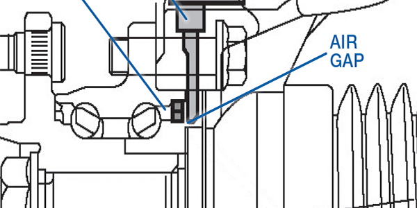

I was able to read the wheel speed for the wheel issue. Im getting a zero reading. the gap between the sensor and the hub is quite large. I tested it on the previous hub/knuckle and the gap is very small. I’m thinking the hub assembly I received is not the correct one. I’m wondering if I can return it? I purchased it at Napa.
If the wrong part was offered, bring it back with the original and have that conversation.
It’s definitely the wrong part. NAPA auto parts took it back and gave me the correct one. This one has a much thicker/deeper bearing. All codes cleared and did not return.
