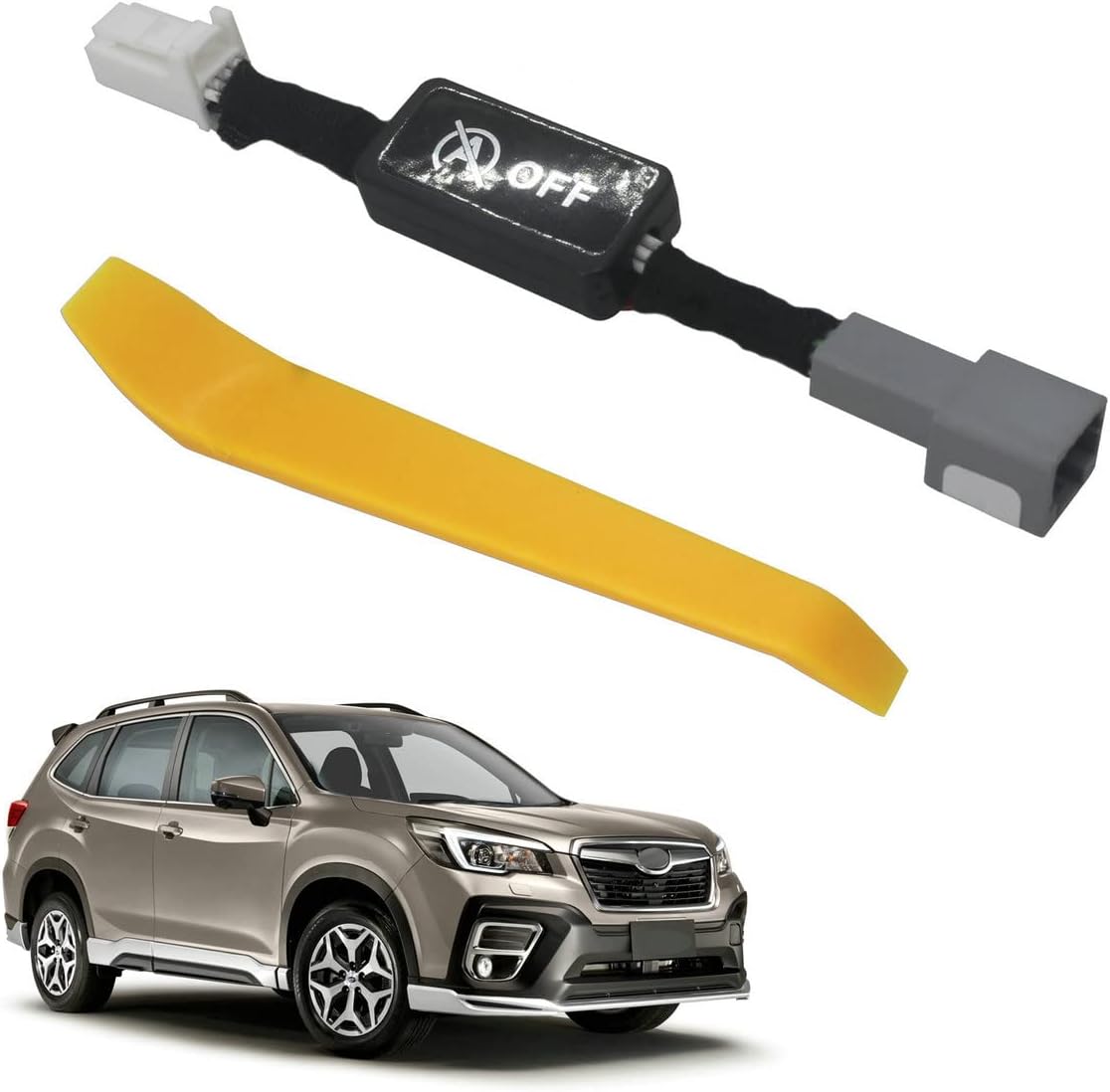

You understand correctly. Everytime you start the car, autostop is on by default. If you want it to stay off you have install something that keeps it off. Unless of course you want it on. In that case autostopeliminator will allow it operate as designed again. In other words it remembers what you want and sets it that way. I had to turn mine back off after a service once when the battery was disconnected but that was expected. I haven't had to intervine since.
I can't wait until it gets here. I'm fumble fingered, so I'll take it into my auto electrical specialist and have it installed.
As Dick Foster pointed out, you can thank overreaching Big Government "oversight" for such frustratingly annoying functions that you can't disable (without wiring in another, costly device). I also urge all auto owners to remember such invasive, ineffectual, ecological over regulation whenever you vote and vote accordingly. I also understand from multiple sources that this feature actually saves less than a thimble full of gasoline on every tank. It is literally meaningless, and only another "feel good" political manipulation.
Yep, I got the eliminator. I actually ordered it before I got my 2024 Subaru Forester last fall (2023) as my son was using it in his '23 Forester.... So I never 'experienced' the inconvenience.... as soon as I drove off the lot and got it home, in went the pigtail (fuse box location). Unclick, click, click, push in cord into fuse box for power, tuck, done. So now the default is 'off'. Still can press the button if I want it 'on' (can't image why I'd want to do that though...) .
Auto Start Stop A-Off Delete/Disable/Eliminator/Canceller Device Cable Compatible with Subaru Forester 2019-2024 and 2019-2023 Crosstrek and Outback Legacy 2015-2019 Brand: BODENLA​

I bought this off Amazon, and I could not be happier. it took me literally 5 minutes to install. Goes behind the on/off button and makes the default OFF. You push the button if you want to turn it on.
Auto Start Stop Engine System Canceler Eliminator Device Cable Automatic A Off Delete/Disable/Cancel Start Stop Function Compatible with Subaru Forester 5th Gen 2019-ON
